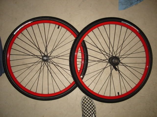

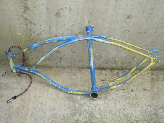

Postby armandgil on Sat Sep 29, 2007 9:31 pm
Sorry guys, not keeping the yellow...it was a 50 mph paint job and I have something else in mind. The wheels are done! Found some nice tires at a local LBS with a tread pattern that goes with my inspiration.
Strippin' paint

Postby musclebikes on Sat Sep 29, 2007 10:02 pm
Sweet!! I like the tires, they look like motorcycle tires. Now that ive seen the pic of the motorcycle im anxious to see the finished bike.

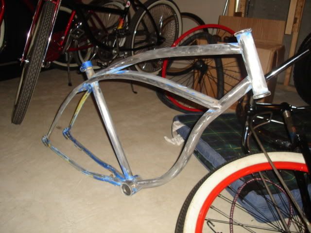

Postby armandgil on Tue Nov 20, 2007 6:51 pm
Oooops, got a little side tracked. But spent the past two days working on it and it's almost done. Here's some pics!

Postby armandgil on Wed Nov 21, 2007 1:45 pm
cman wrote:I like the bare metal frames. Simple and shiny. How did you mount that stem- w/Threaded to threadless adaptor?
Yes sir, I think it's called a quill adapter or something like that. I've had it for some time and never used it until now. The frame is almost bare metal, I polished it for about an hour by hand and that was after trying to get the same consistency throughout the whole frame with a wire brush wheel thingy. I also removed some unsightly tabs and smoothed everything out with my 4 1/2 inch grinder with a flapper wheel and a cutting disc. Next time...I think I'm gonna paint. I chopped both fenders to give it the bobber look and notched the forks to lower the front end without bending the forks. I cleaned and repacked all the bearings but I didn't take pictures or I would've gotten grease all over the camera. Here's a pic of my mess AND almost done!
