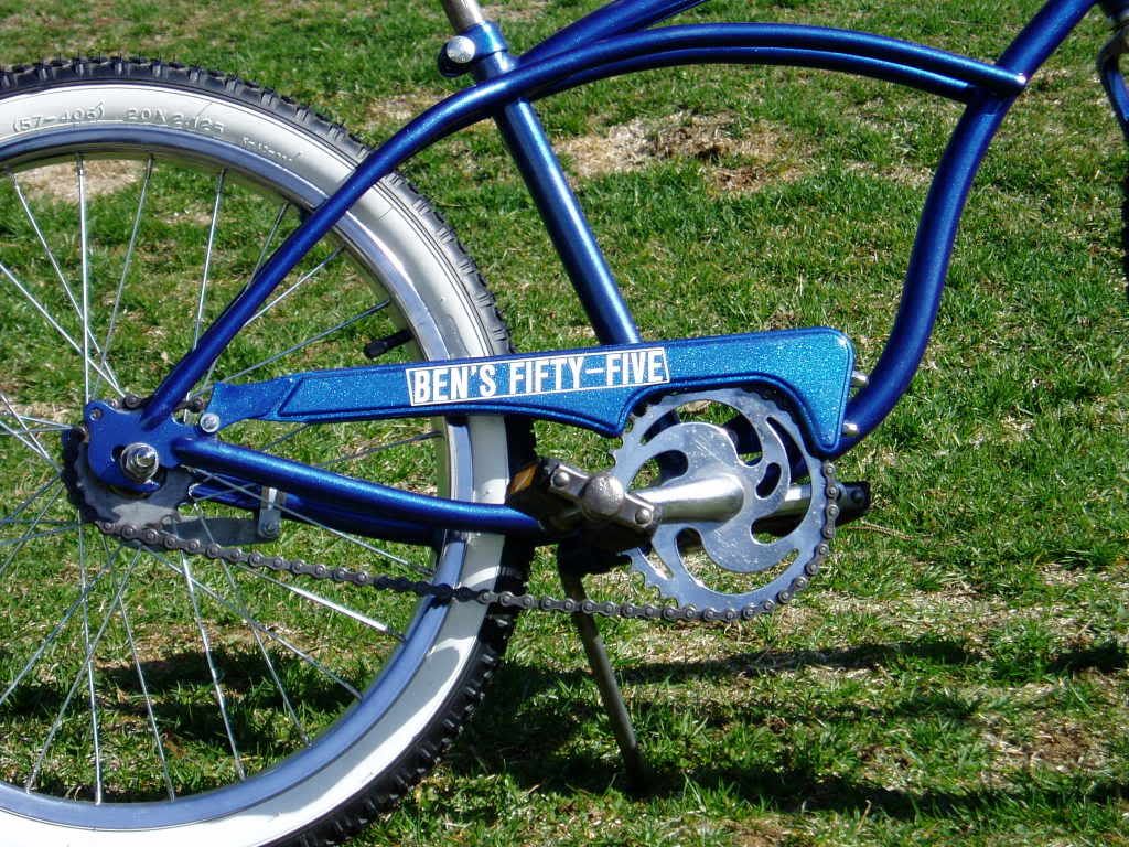

Postby ej599 on Thu Apr 10, 2008 1:05 pm
Just a tease.

Postby xddorox on Sat Apr 26, 2008 6:56 pm
Excellent work, that paint job is awesome!

Postby ej599 on Mon Apr 28, 2008 8:32 pm
Thanks all. Rustoleum metal flake.

Postby ej599 on Tue Apr 29, 2008 8:00 pm
I went to rustoleum's web site and didn't see any. They have a few cool colors on line that I haven't seen in stores. Check that site out. The trick to that stuff is to make sure you don't hold the can too close. Otherwise the force of the presurized liquid paint coming out of the can blasts the metal flakes around. You want it to almost just fall down on what your painting, like snow, especially your last coats. I find I use a little more of the metallic than I would using normal paint. So buy enough. :mrgreen:
Oh yeah, don't forget the clear coat!
