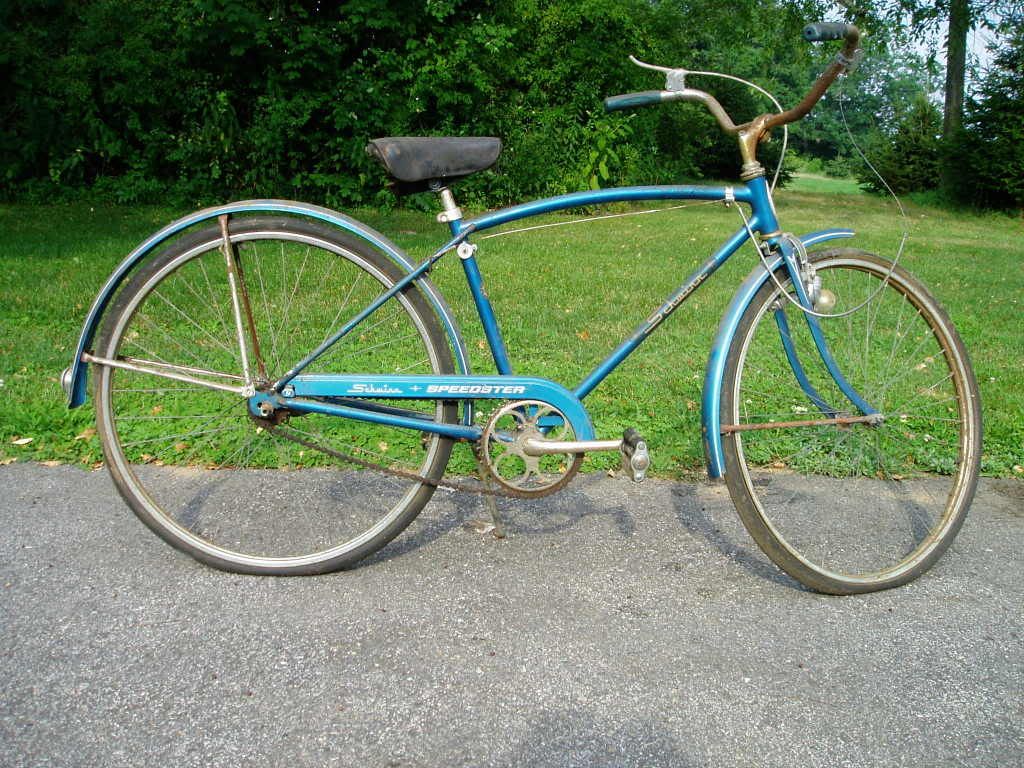

Postby ej599 on Sat Oct 18, 2008 6:43 am
Well, I have this blue 67' speedster or this red 71' racer, a S.A. 3 speed hub and a set of NOS 24" s-7 hoops which I've located some tires for. Now all I need is spokes. I was told there 9-3/4" but if someone has a spoke chart and could verify that, I'd be grateful.
