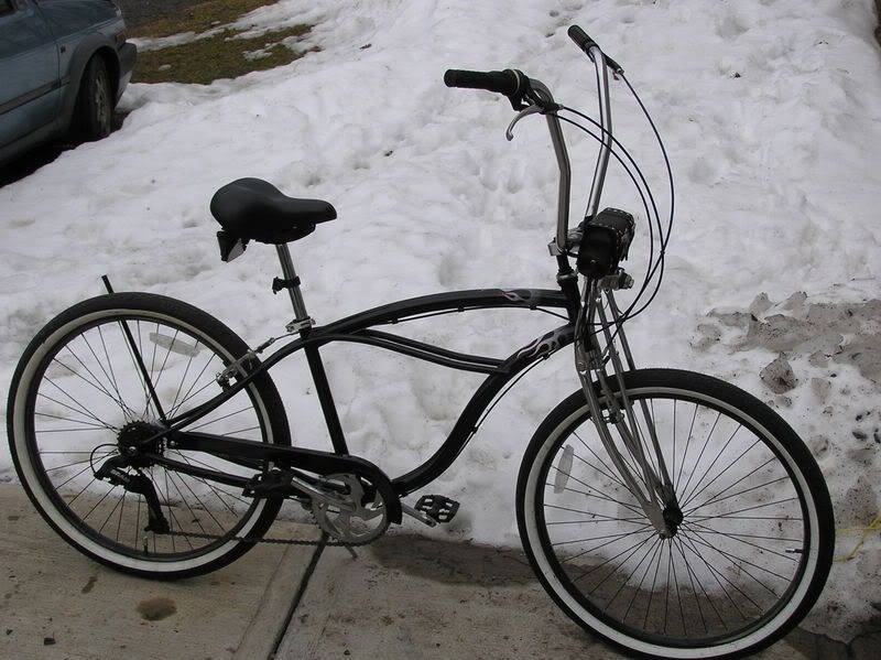

I am mid process on this one already. I started it this afternoon.
Our camera was MIA last weekend when I was collecting the parts, so it will be somewhat limited in progress pics.
Here is the parts list:
Mongoose cantilever frame w/ American BB shell, canti posts and built in derailuer hanger.
RST 1" suspension fork
Deore XT 7 speed rear hub w/ Sun rim
Deore DX front hub w/ Matrix rim
Kenda K Rad 26X2.3 blackwall knobbies
1" threadless stem with off road motorcycle bars.
1" seat post w/ integrated clamp and WTB SST seat.
Most likely a Deore DX rear derailuer
I am shooting for a top mount thumb shifter with Deore XT servo wave levers and canti brakes.
The crankset is undecided right now. I was thinking of using a Suntour Superbe Pro or Deore DX set I have with a euro conversion BB. Either way I don't think I am going to run a front derailuer.
This is what I started with:
It don't make her a bad girl, but it does make her popular.

Postby 62Higgins on Sun Oct 26, 2008 10:08 am
It is now ridable.
I have not tracked down the thumb shifter yet, so it still has grip shift. I did find an old Shimano Bio Pace crankset though. I had to remove the inner ring to make it work with the euro conversion kit I had, but no big deal as I was not running a front derailuer anyway. I found some of my old cage pedals with toe clips and put them on too.
It still has a SRAM rear derailuer on it too. I will swap that out when (if?) I find the shifter.
Scott ATV grips wound up on the dirtbike bars, can't decide if I want the pad on the cross bar or not. Stuck with the V brakes too, as there aren't any cable stops on the frame...which I never thought about. It's been a long time since I put cantis on a bike on purpose.
I am sending my son out for a test ride on it and then we'll get some pics up now that I found the camera and the sun is shining here again.
We came up with the name from a Clutch song. I think Clutch is the best band you've never heard on the radio, check them out, there are a ton of their songs/videos on Youtube. .
