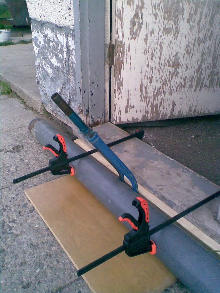

I decided to go with a "stock" fork, as opposed to the triple clamp style I was also considering. I want kind of a big n' littles thing going on, and the crown and large tubes (1 1/8") would have added too much bulk to the front. I set to figuring out how to bend the stocker to set the crown near the 24" wheel...
here is my first attempt... which failed miserably. the clamps just slid open, and even if they had held, it probably would have pulled my threshold off the door... my garage is ghetto.
I had these gratings lying around, which covered my oil change pit. they are made of 2"-ish heavy tubing, spaced about the same apart. I stuck the fork in there and put my weight on it. I had to bounce pretty good with my whole weight out on the steerer to move it at all! Unfortunately, once it did move, it caved in the tubing a little bit. Now I'm frustrated, which is why I didn't take any pics of this. all in a fuss, I stripped another 26" fork off another bike, and had at it again. this one had smaller diameter tube, so I figured it would bend better without kinking, which turned out to be true. it also has nicer dropouts. the original fork also had a cracked steerer up where the washer rides on a flat, so there was the potential that I would have always had headset trouble with that one anyways. I will go back out and take a pic of the setup I used to bend,later, now that I'm not all upset about it.
here are a couple pics with the new fork:
