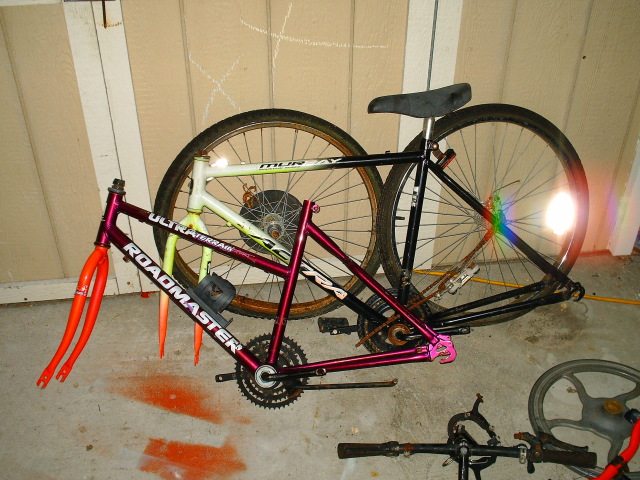

Postby FunkyStickman on Sun Jan 17, 2010 10:00 pm

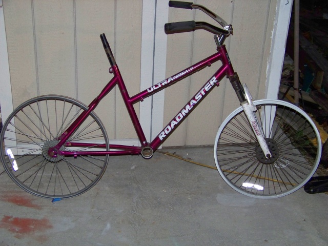

Here's the frame I'm starting with (the purple women's 24" MTB frame).
Mocked up with a 26" fork:
Plans are for whitewalls, a banana seat, and a custom laced rear wheel, probably a 3-leading 3-trailing pattern.

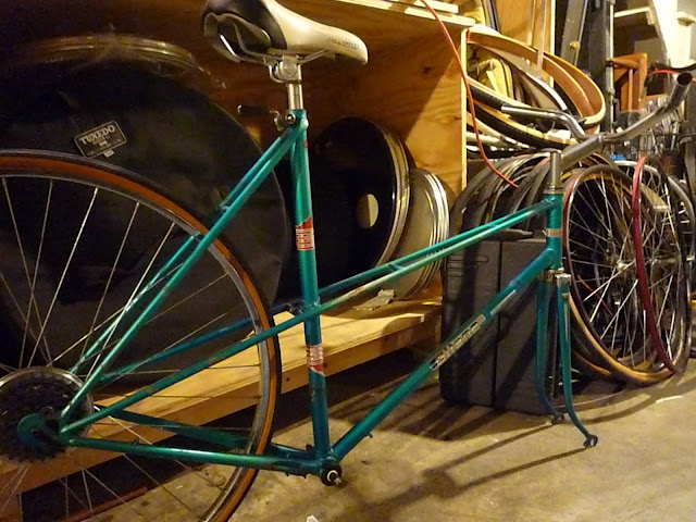

Beginning at the beginning-
it's all there!
Lotsa tape-

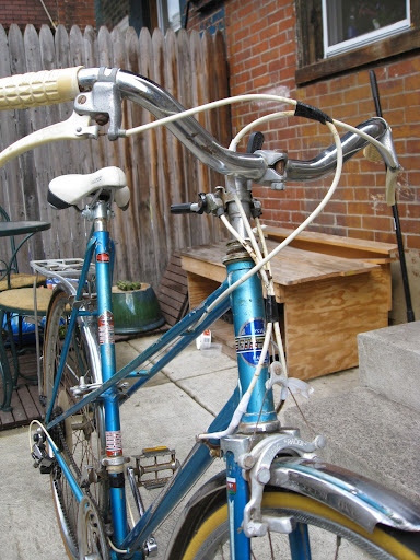

Lotsa gunk, some rust, a real alleycat-

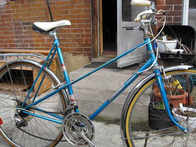

I picked up this Gitane for a build that never panned out. The combination of worn parts, French stuff, and a bent fork conspired against it. But, it's a cool color, and it's got a lot of good stuff on it, so it should live again!
The concept for this build is French with an American accent. Which usually ends up horrible, but that's the fun. :D
Adding some pictures as of 1/31/2010 (cause you never know, this could stretch out a bit.)
Stripped down the old girl and assessed conditions of parts. Threw in a square taper bottom bracket spindle, which I may or may not keep. (I kinda like the cottered cranks that are original to the bike, I might try to find the original spindle and keep them.)

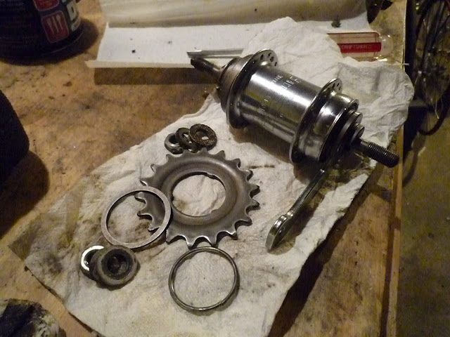

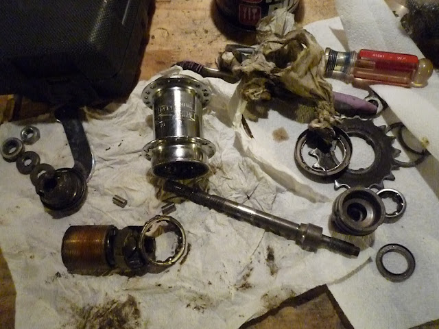

Also took delivery of the Sturmey coaster brake hub, and set about cleaning and rebuilding it.
Sometimes, the only way is to get stuck in, before you think too hard about what you're doing. I always am a little nervous disassembling a hub with internal mechanisms. This is my second coaster hub rebuild, and I've never exploded a three speed hub before. Maybe that'll be my next build? Still, it seemed to go well, everything went back together, and feels smooth and proper.
Now I just have to get the rest of the wheelbuild together. Once I've got wheels, it should go pretty quick. Still working on how to make this a "special" build.

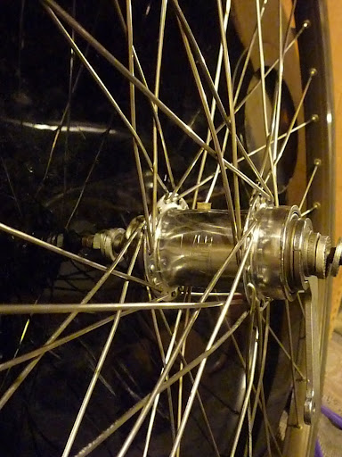

2-12-2010-
Making progress. Got the rear wheel built, now I have to get some sizable tires on it and start futzing with fenders!
3-20-2010-

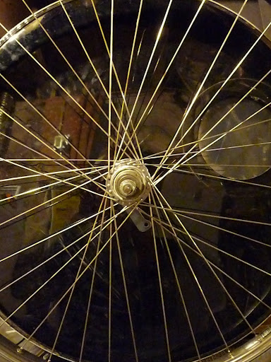

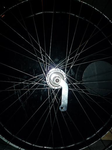

Progress is still being made, I've got more done than these pictures, and the shakedown ride went well!

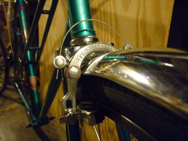

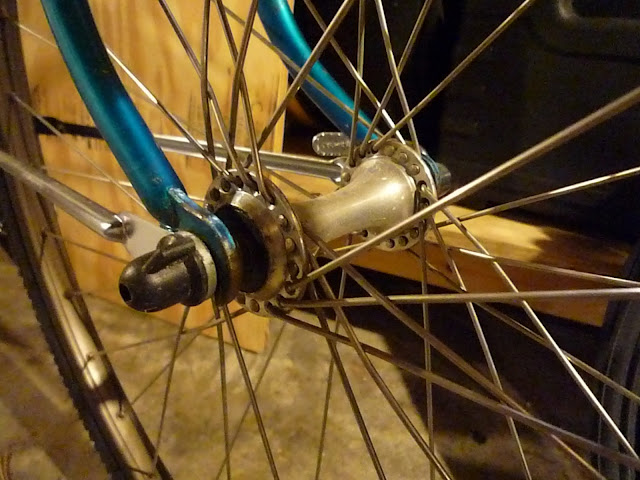

Front wheel re-laced
The front is getting a Mafac racer brake, which is a nice bit of jewelry, but also works *very* well to stop the bike. Which is good, because the Sturmey coaster hub is really more of a "speed modulator".

Postby thirstee on Tue Jan 19, 2010 11:29 pm
My wife's birthday is in April so this will be a great motivator for me. She wants a rat with baskets and apes. I have a frame to start with and a lot of parts to dig out. This is going to be fun! Good luck ladies!
Here is the frame of unknown origin.
Update 1/26
I dug out some of her parts and started stripping the paint, just gotta hit those tight spots yet.
I had previously used these forks to practice bending on as they are dented on one side and figured no big deal if I screwed em up. I threw a tire on and it seems like it might be ok but I'm kinda skeptical. The steering tube is also bent so I need to see if I can straighten that out first. Oh and the tire clearance might not allow a fender, so I have that to think about as well...
Update 1/31
Found some more parts. I plan to paint the rims and fenders. More prep work. :|
