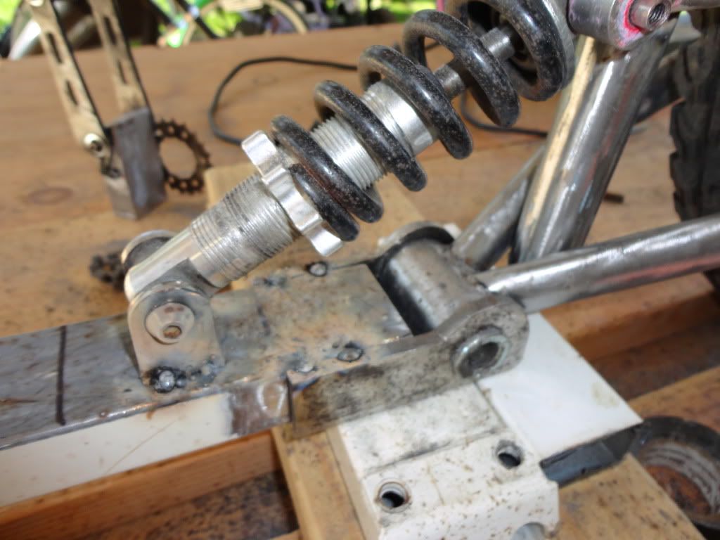

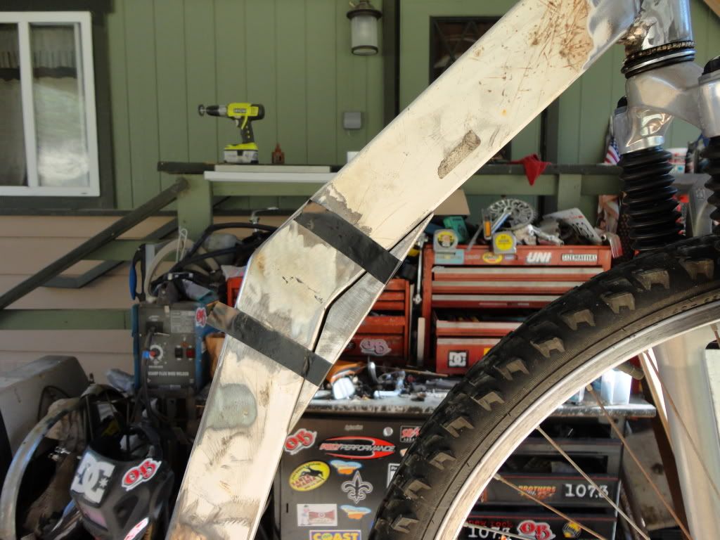

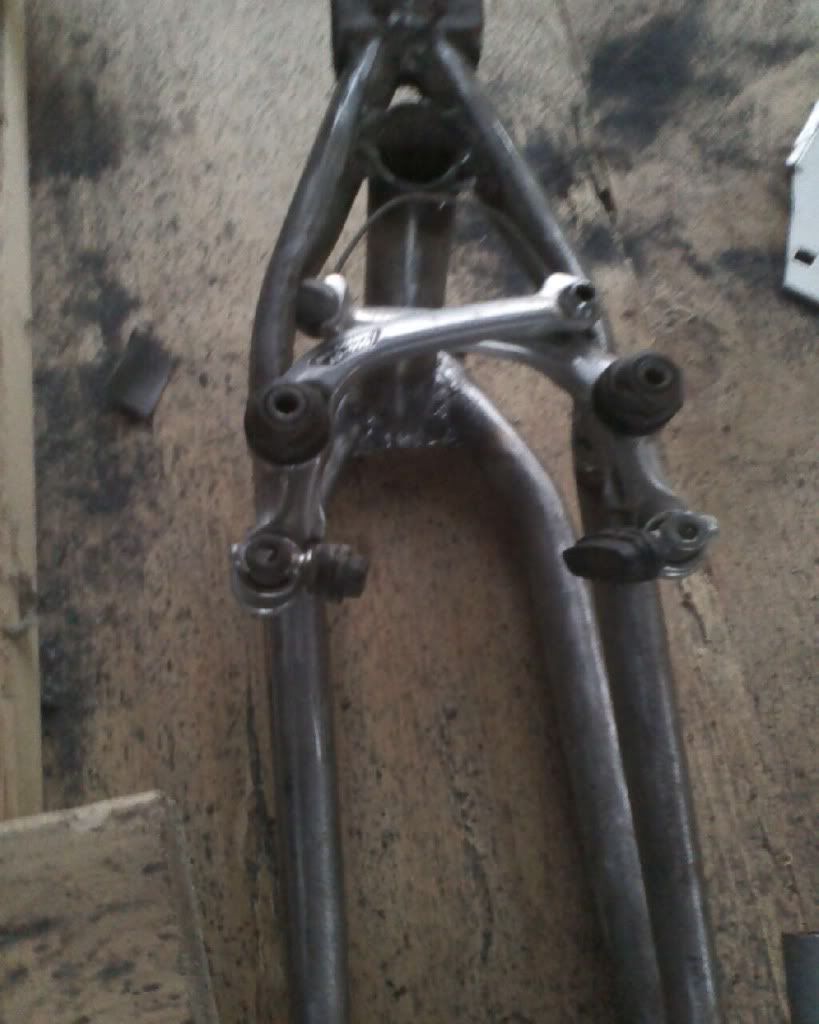

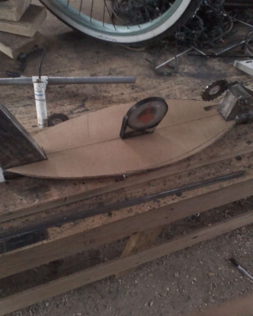

Heres the template/cardboard deck .Ididnt want it to fat or skinny what do ya think? ImageImageAnd heres the rear brake mounted under the swing arm...Image

I like those brakes. What are those? That deck looks good. What about fatter at the front? Kinda tapering back?

jackdaw wrote:I like those brakes. What are those? That deck looks good. What about fatter at the front? Kinda tapering back?
I agree the deck could be a little wider up front and the brakes are some old center pull shimanos I took off a Nishiki MTB they mount on the bottom of the swingarm ...

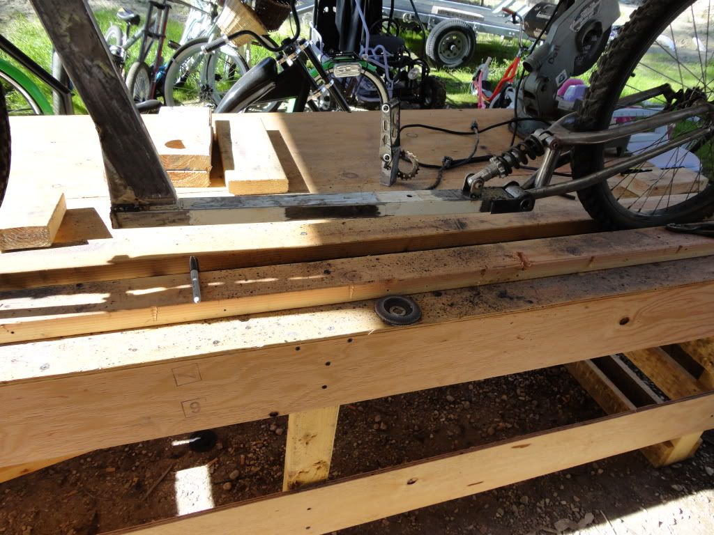

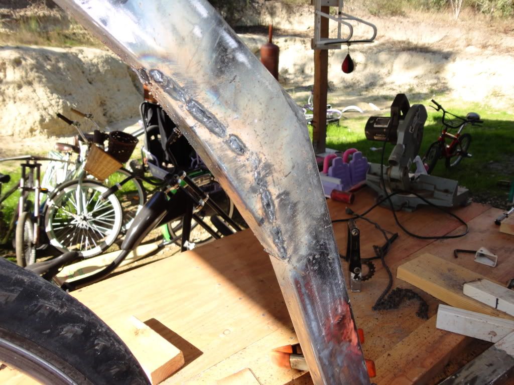

Tonight I was able to make the deck :D The diamond plate went out the window and I made my own...I started with some 1/8 aluminum and engine turned it with a wire cup brush,then threw on a 2" strip of grip tape on it !So what do ya think?I like how it came out I might put some pinch moulding around the edges so it doesnt slice any ankles!Tomorrow Ill finish the welding I have left to do and hopefully start some body work! 8) :mrgreen: ImageImageImageImageImageImage

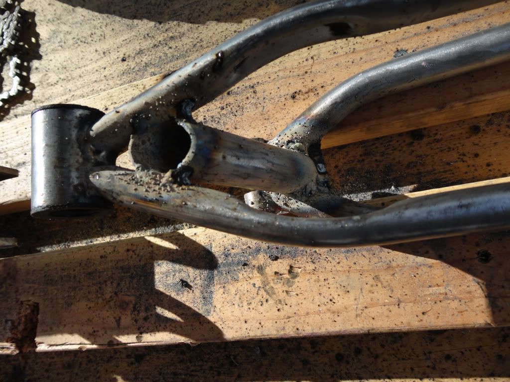

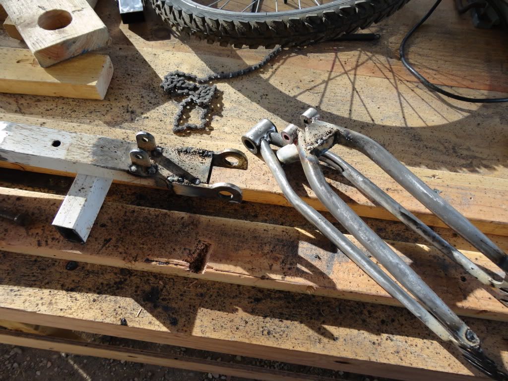

The day has finally come when im actually starting to lay down some paint!!!I got the bottom of the frame done and body worked along with the swingarm,neck and bars...Now there all in primer just some fine sanding and then color!Im getting anxious to assemble this and call it done!Ill try and paint it tomorrow but if all goes well!! 8) :mrgreen: ImageImageImageImage
