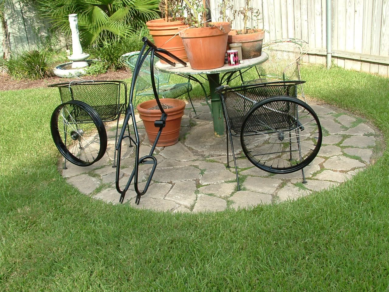

Ok everything is going to be black. Not taking any chances with too many colors. :shock: :shock:

Those wheels look awesome in black!!! 8) 8) Are your new forks black or chrome?

Re: The Fix
Postby Uncle Stretch on Fri Aug 10, 2012 5:19 pm
They are chrome. Should add a little pazazz to the build. I just checked and they got to Hutchins Tx.
They say they will be here tomorrow. This bike place is really good. $49 for the forks and $18 shipping
If it gets here in the 3 days I'm going to be really impressed. Heck if they make it by Monday I will be happy

Re: The Fix
Postby Uncle Stretch on Fri Aug 10, 2012 9:19 pm
Hey Houndog its a place called Bikebuyers.com Now I have no idea of the quality. When it gets here
tomorrow I will be able to check the quality of it and give a report. They seem like straight up people
so far, but their kinda limited on what they carry. I checked most of what they had and the prices looks good.
Ed I'm glad you like the build. Its hard to tell just how it will come out. I have made a few mistakes on color choices.
Hopefully all black will solve that. It rides good. Now just to make it look good. If not I will pull the wheels and parts
and cut it up and try again. Most everybody knows my builds hang by a thread till they are done. I will cut one
up in a heartbeat if its not what I want it to look like. This one was actually just a trial to see if I could bend
a one piece rear triangle with my JD2 bender. It really was never ment to get to a finished frame. Chuck sold
me the wide rims cheap and it snowballed from there. :shock:

Postby Uncle Stretch on Sat Aug 11, 2012 7:38 am
Well got the front one done. Looked online and my forks are out for delivery. Probably going to
take a little work to install. I don't have one of those big clunky things that hold the bars on a threadless
headset. Will take me a while to change it to where it will work. Ok I'm excited! :wink: :lol: :lol:

Postby Uncle Stretch on Sat Aug 11, 2012 5:01 pm
Finally the FedEx guy got here. Waited till the last minute. The forks are nice for $49. They are
cast aluminum instead of being machined out of a block of aluminum. The one cool thing is they
put the threadless neck in and clamp it too. You can pull out a C clip and take it out if you want.
I took a regular threaded top race and ground the threads out and slipped it under the top tree
and then tightened it all up. Worked perfect. It rides good and I'm happy with the way it looks.
