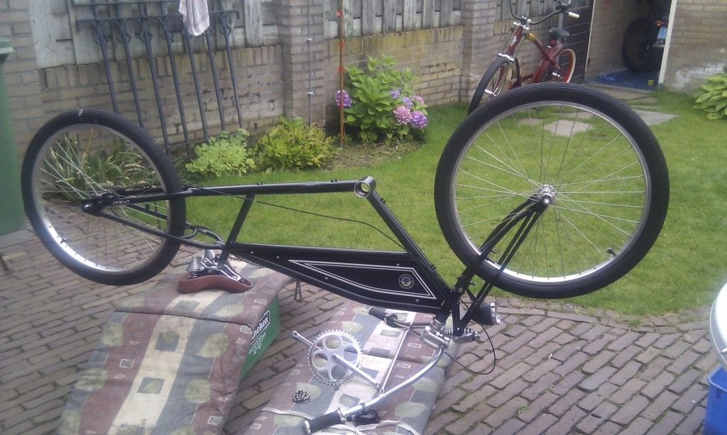

All the parts in the back of the car,a lowglide in one piece doesn't fit the trunk of a VW Polo.
Once @ home took all the parts out of the car,and yes for those who don't know yet.

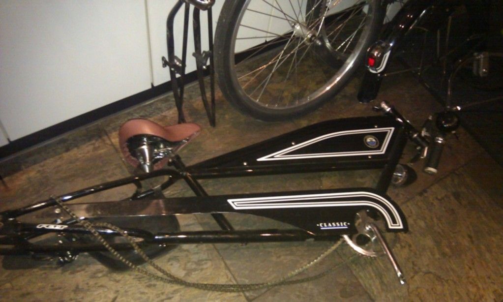

I've scored a Felt Classic Stretch.
The frame has some minor scratches on it.
The tank plates and chainguard are in good condition.

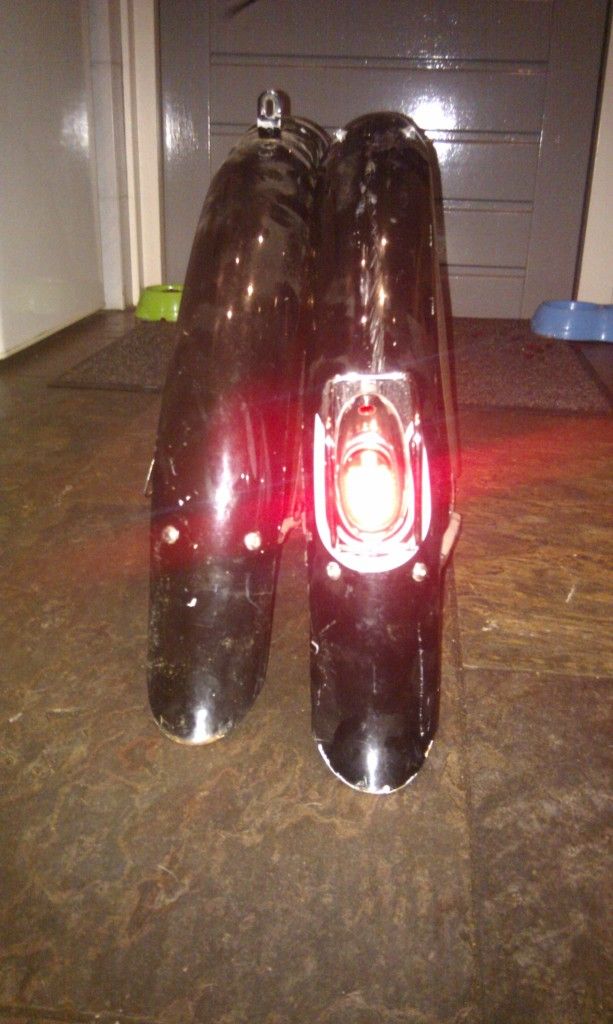

The fenders are damaged a lot, they have scratches and some dents.

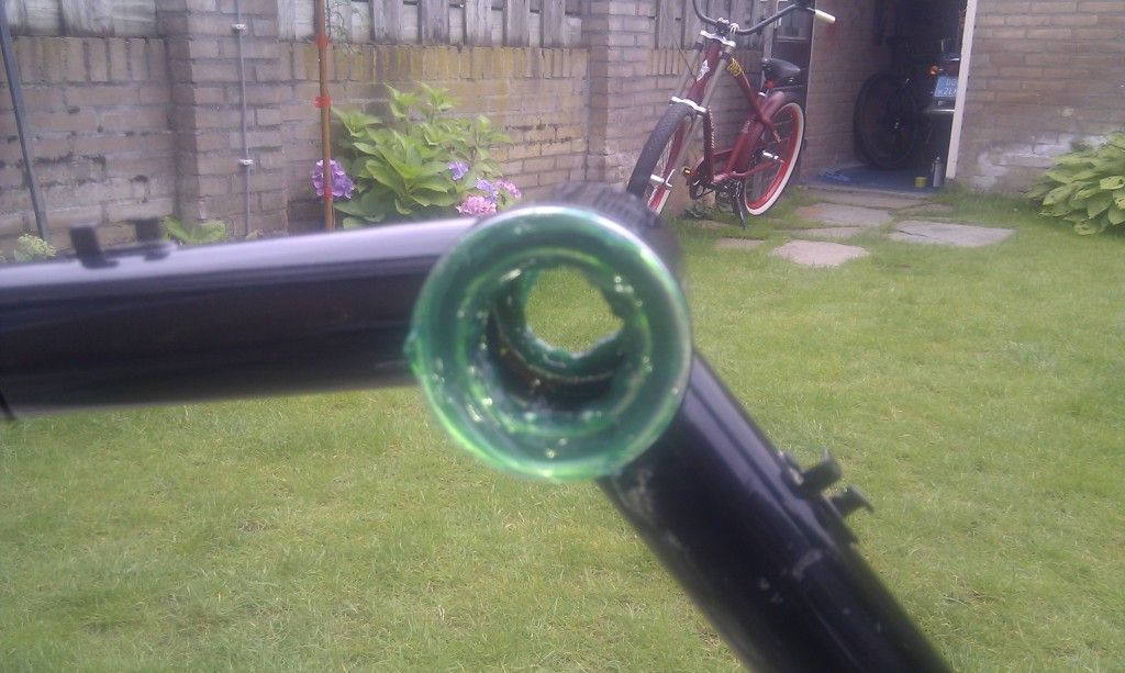

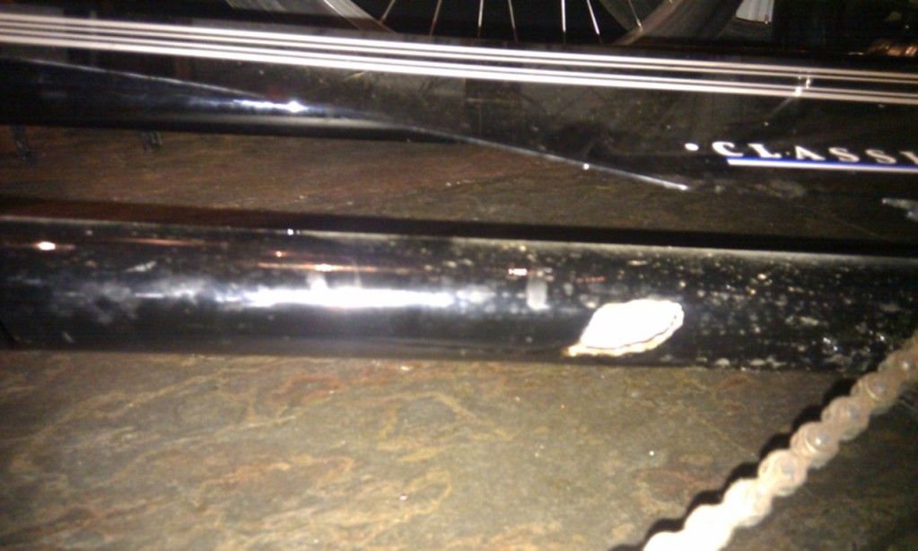

The biggest problem with the frame is that the kickstand is broken of it, and there is a big hole in the frame.
That the kickstand is broken of the frame is not such a big problem, there are more Felts which have that problem.
It just needs some welding to fix that.
The guy who sold the bike didn't have the kickstand anymore, that was for me no reason to not buy the bike.
Just used it to lower the price. :lol:

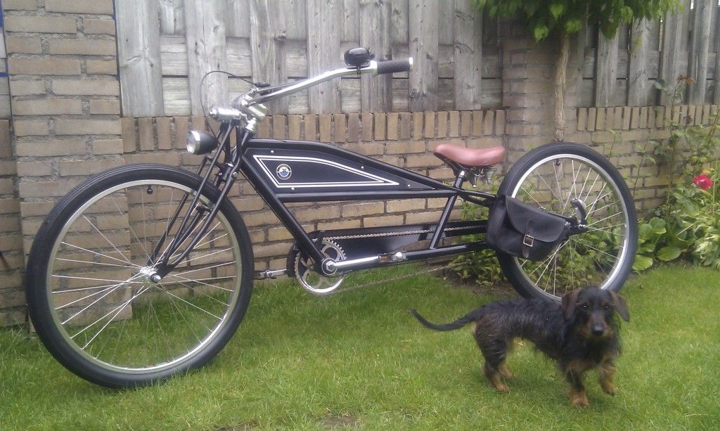

Together with the youngest building up the bike again.
And it's build up again.
@ First sight it looks like the bike isn't used much.
Because there is almost no rust to find on the bike or the chrome parts.
I think the bike got more damaged from standing still, than it has from driving with it.
As i said before the frame has some scratches, and a little dent where the springer has touched the frame.
In the future it could use some new paint or powder.
The leather bag thats on the bike, came also with the bike.
It's not in great condition,but it is a nice bonus.
The front fender is bent and has some paint damage.
The rear fender is bent also has a few dents and a lot of paint damage.
There also is mounted a rear light to the fender.
But with some paint repair, i think the fenders will look okay again.

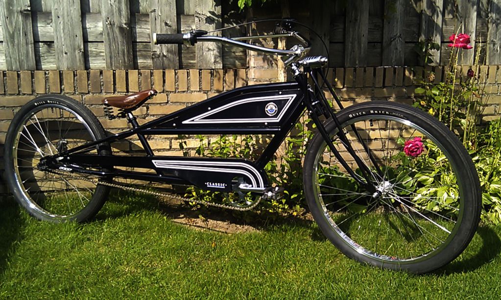

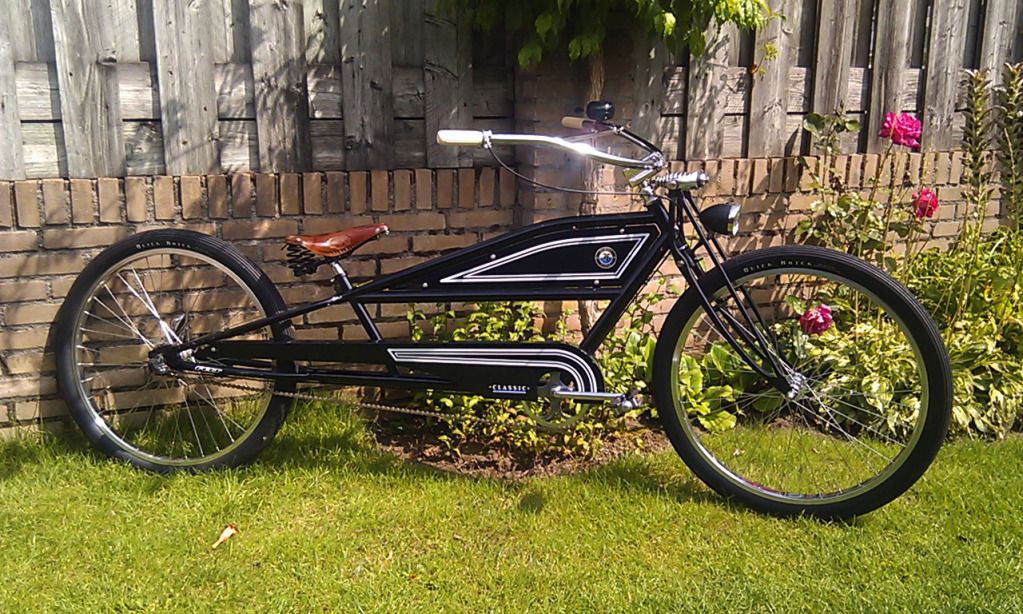

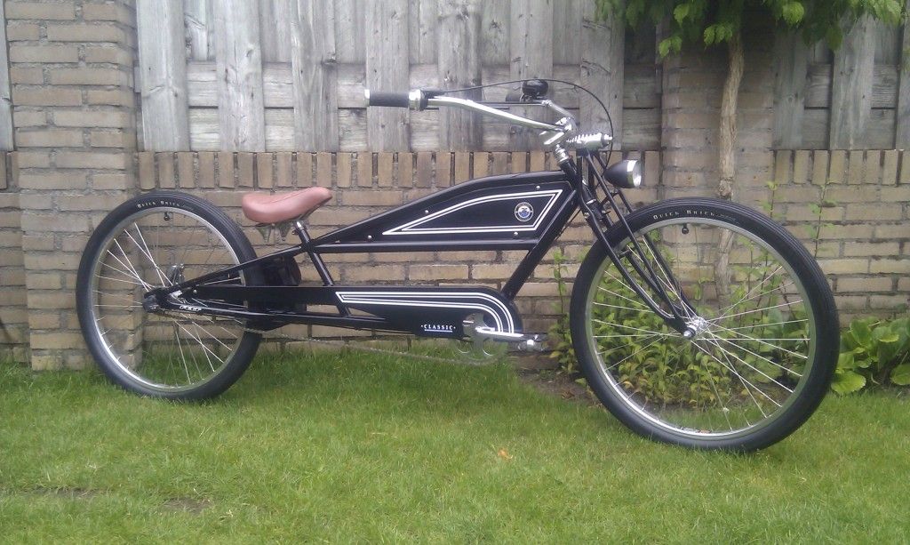

How the Classic looked after this treatment.
Made a little test ride and felt that the springer needs some adjustment.
Further the bike drove okay and everything works.

Your dog matches your bike...maybe you should put a basket on it!

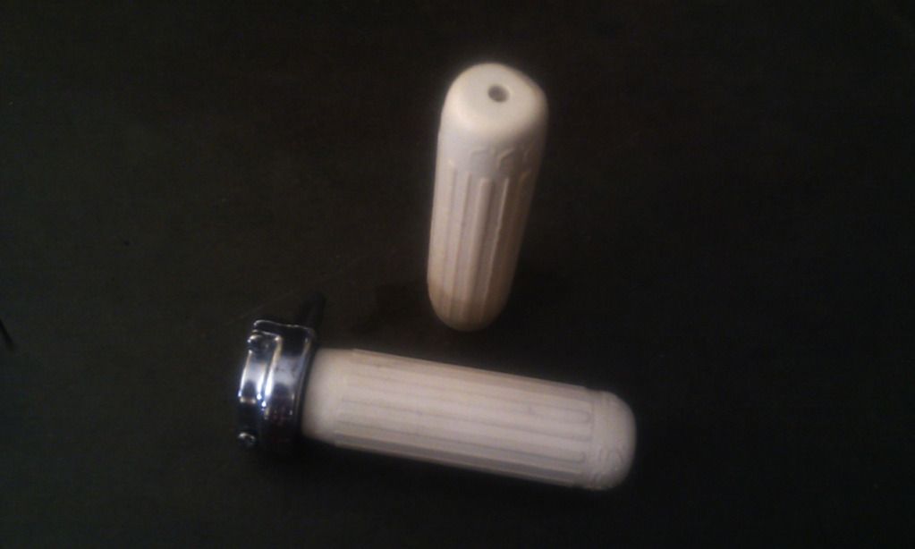

First have bought me new grips for the Classic.
Because i wanna go for all brown parts ,the white 333 grips have to go.
But the 333 shifter is gonna stay on.
The 333 shifter,and the new grip.
Because the 333 grip is shorter, i'll have to shorten the new grip.
First took the 333 grip of the shifter,and took the new grip apart.
Because the 333 Shifter is a few mm thicker then the handlebar,the aluminium rings didn't fit.
So i took the Dremel and some sandpaper,and after some time they did go on the shifter.
The black part didn't fit also,so i left that one out.
In between the aluminium rings,the grip has to become thicker to fit the leather rings.
I did that by wrapping some tape around the shifter untill it was thick enough.
Then i put the rings on and put the whole shifter together.
The left grip is cut off at the same length.
Then put the grips on the handlebar.
Close up, yes i think it will work. :D

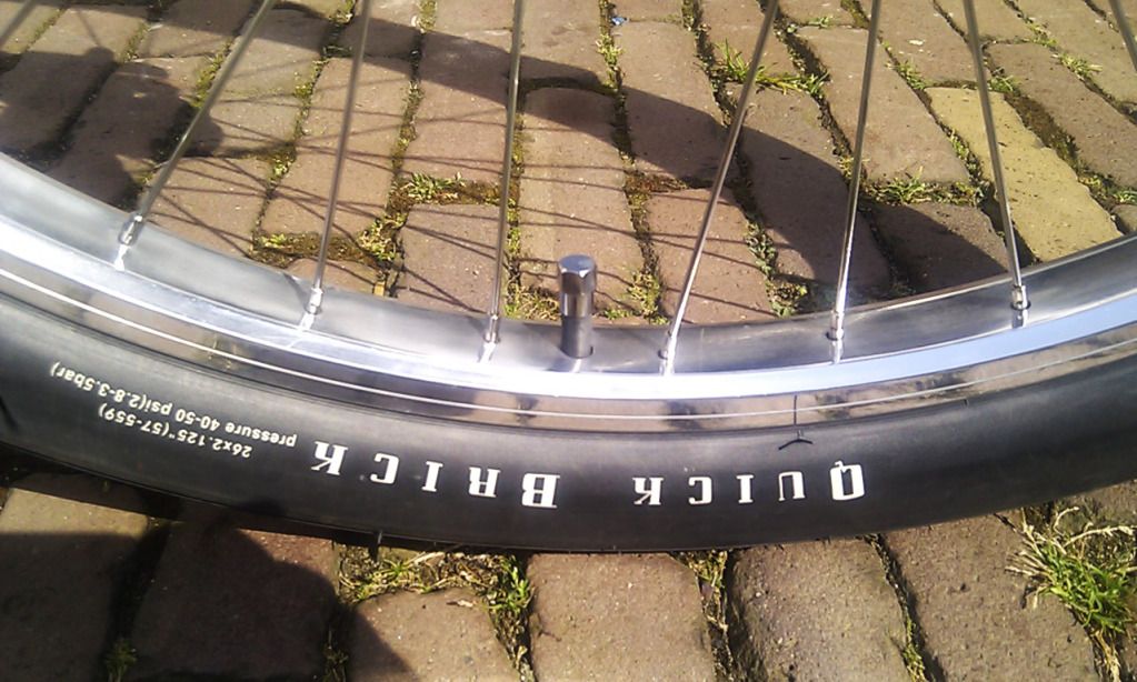

I would like to have this Brown Quick Bricks to put on.
But they are not for sale here in Europe.
I have been looking to buy them in the U.S. and have them shipped over,
but that's getting to expensive for a pair of tires. :cry:
:idea: So now i think i will go for the Brown Schwalbe Fat Franks, as they are for sale overhere.

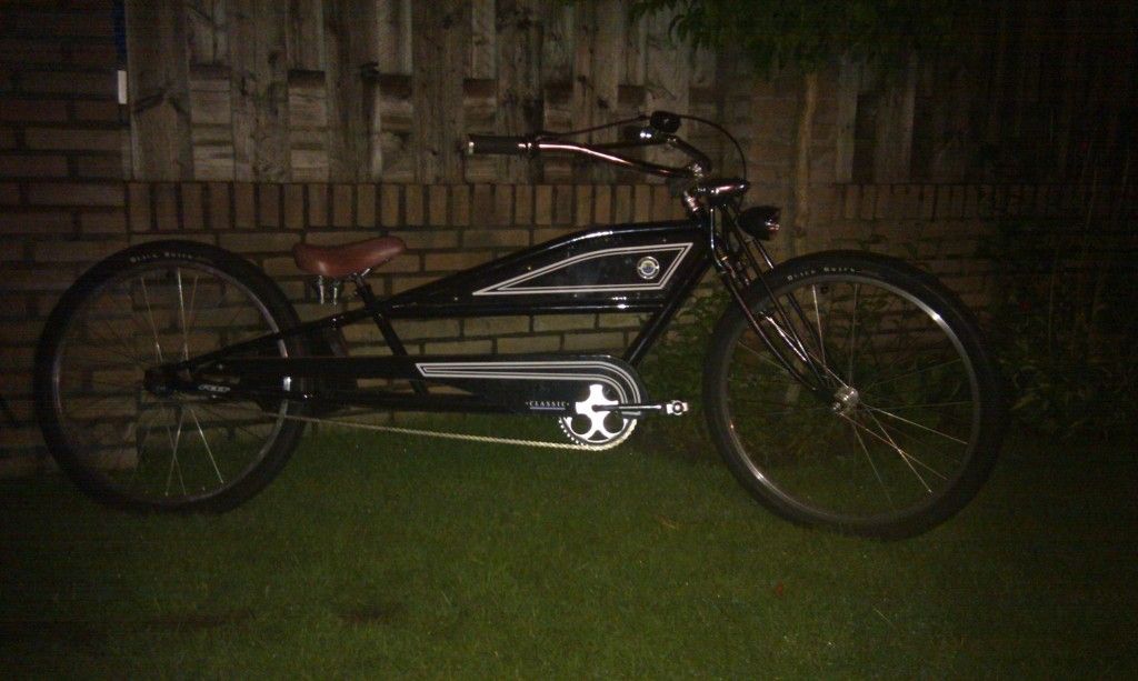

Postby Lowjack'r on Thu Aug 30, 2012 1:24 am
Tires are in.
And placed :D
I think i can live with this
:idea: Next to come a pair wider rims.
But first ride it for a while like this.

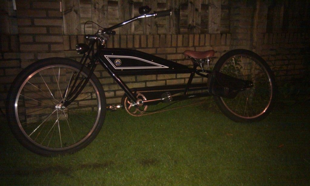

Postby Lowjack'r on Fri Sep 21, 2012 10:18 am
Mole wrote:I think it'll look great with the fenders repaired and reinstalled.
I've put the rear fender on.
Just to see how the fenders look on the bike.
