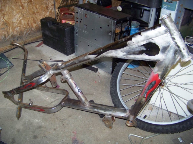

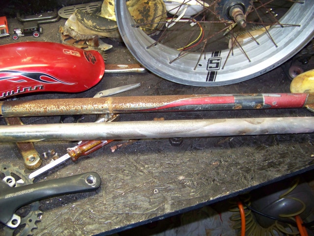

Here's the beginnings of sandblasting the frame. It's not as fast as I'd hoped, mainly because my compressor can't keep up. I have huge industrial stuff at work I could use... hmmm....
Here's a before and after of the fork legs:
I'm tossing around ideas for replacing the fork legs. I can get 8 feet of 1.25" aluminum 6106 tubing for about $20, it would be about as strong but weigh half as much. Anybody tried that before?

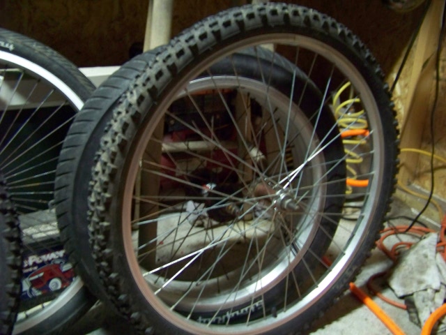

Okay, quick update. While I was removing the V-brake bosses and the welded-on kickstand, I decided to measure what the bike would sit like with a 24" in the back, instead of the stock 20x4. Lo and behold, it puts the axle only 1" higher than the 20"! Mostly because the rear tire is soooo huge. I honestly thought it would be higher than that. That's what I get for not actually measuring it! "Well," I figured, "I can deal with one inch higher in the back, and if I put a MTB rim in front, that puts the front one inch higher as well!" So you can imagine what I'm thinking! I have a set of spare 24" and 26" aluminum rims with junk hubs, so this is totally doable. I just need to re-space the rear dropouts.
Here's some shots of my (slow) progress.

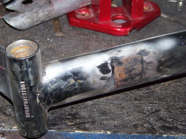

Cut off the kickstand, look at the rust under there!
24" next to the Stingray 20x4".

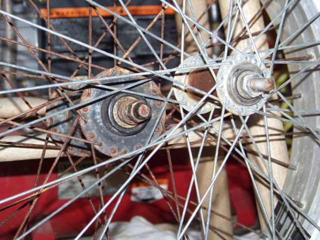

Looks a lot bigger, but the axle's only an inch higher. Look how rough the Stingray spokes and hub are.
The frame, 90% stripped/sanded and almost ready to paint.

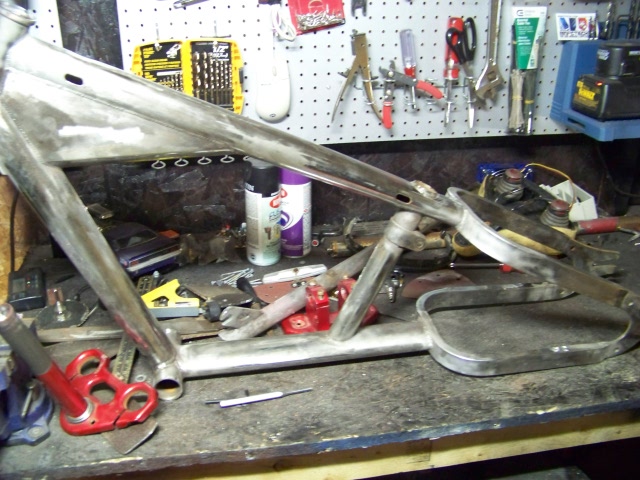

Postby FunkyStickman on Tue Jun 16, 2009 7:56 pm
I did a little more work on the bike tonight. I finished smoothing the parts I cut off, and narrowed the rear dropouts to 135(ish)mm. More importantly, they're evenly bent, and the bike should track straight. I may bend them a tad more and parallel the dropouts, which makes chain adjustments much easier. :D
I also disassembled the fork crown, and since one clamp bolt was missing, I cleaned and re-tapped the threads, and I will pick up a new pack of about ten M6x1 hex bolts for it. Every bolt on the fork is an M6, except for the two "stop" bolts, which I removed and will replace with proper fork tube bumpers.
I'm loading the frame into the car to bring to work... we have several sand blast cabinets I can use after hours, and the thought of finishing the frame and fork legs is outweighing my desire to do it all at home. I just want the thing painted, so I can start working on the wheels and drivetrain. I won't bore you with pics yet, there's not much to see except my messy workbench. :oops:

Small update: I was getting along very slowly with sandblasting (though it's great for hard-to-reach spots) and wire wheels, so I bought a 3M Scotch-brite abrasive disk. Man! I was not expecting it to work that quickly, or that well. But work it did! I was able to completely strip the fork legs and frame in one night. The decals were particularly stubborn, but a combination of the disk and a sanding sponge managed to get them all off. The parts are primed with etching primer, and awaiting black paint and parts to become a bike again!

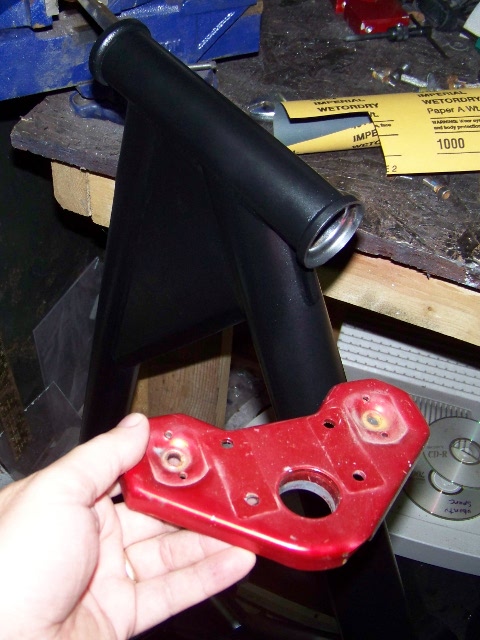

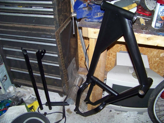

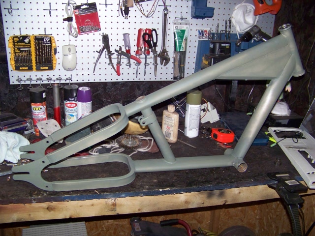

Painted the frame and fork legs today!
Gonna look good with the clear red fork crowns! I might paint the rims clear red to match instead of bright red...

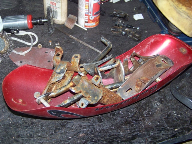

About 5 pounds (not exaggerating) of stuff I won't use off the bike, including the kickstand and fender mount.

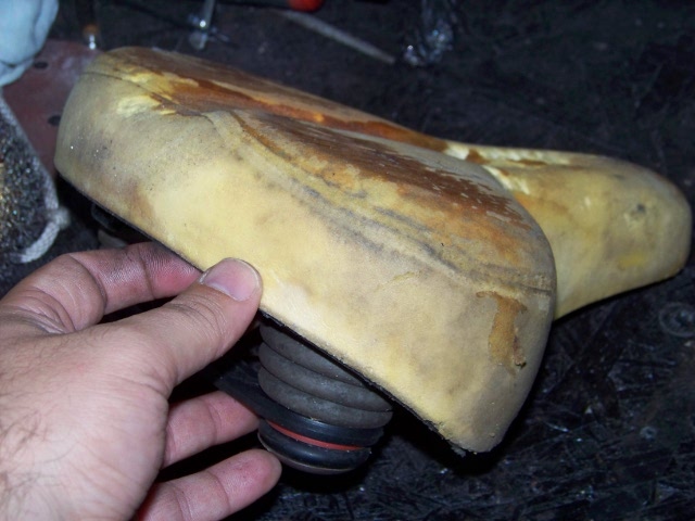

And here's the seat I found in the trash. No, it's not a real springer, but for free, meh. It'll at least be comfy when I recover it.

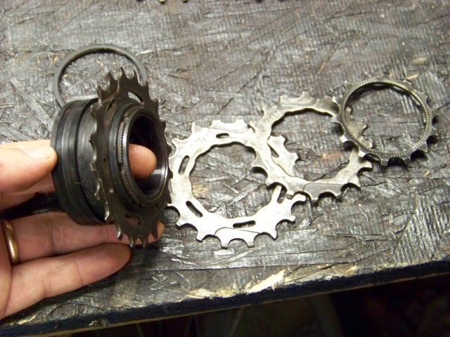

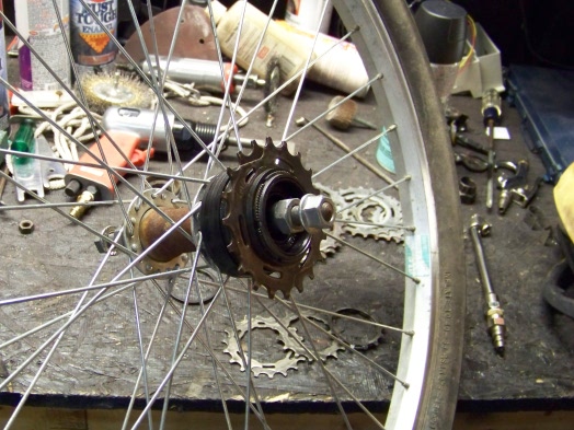

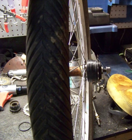

More fun while I'm waiting for the paint to cure! So what do you do when you've got a couple of old 7-speed freewheels laying around? You take an air hammer and disassemble them!
Man, look at all those spacers... that gives me an idea!
Single speed freewheel! I got 20T, 18T, 16T, and 14T interchangeable cogs!!
On the wheel!
Looks like this would clear a 3" tire, eh?
