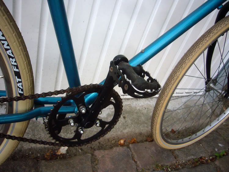

^ I put the pedals that were on my Cartboardtracker on this build and bought new ones to replace the others. Maybe I do some fabricating and make some custom pedals. If I've got some time soon....

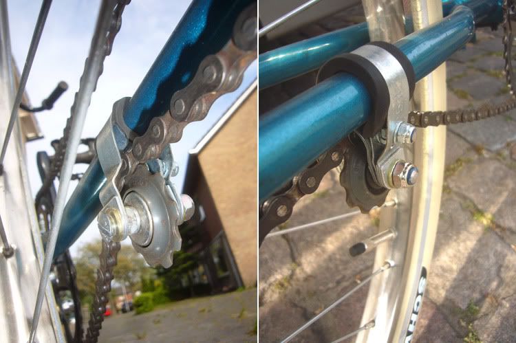

^ As I said, the chain popped off of the chaintnesioner-thinghy I slapped on so I made a quick guard, just by bending another clamp over the one that was already on the chainstay. Hope the pics are clear enough to see how exactly: The inside clamp loops around the chainstay and holds the derailerwheel on one side. The outer clamp loops around the chainstay and holds the wheel on both sides. Making it rigid enough to brake.

Make sure you know ow many links you need before you order a half link. They are made short for bmx. I had to order another for my hustler build.
Half link. Being a half link... doesn't that make me need two times as much links as a normal chain...? I have some bmx specialist stores around town so I can check with them first. I'm not much of an internetbuyer. I want to go to the store and always see and touch what I want to buy... :wink:
Repost: Ofcourse. I'd be honoured if you do so... Just let me know.
Re: >>> SINGLESPEED HOTROD >>>
Postby deorman on Sat May 07, 2011 7:06 pm
JoKeR63 wrote:I was thinking just 1 half link, Yikes!
You'll need to use 1/8" chain, however. Your LBS should have one.
:| One is enough to fine tune chain length for minimal slack.
haha, I know deorman. But I think I'd go with the whole halflink chain. Because I like the serious look of it.
But I still hope there isn't going to be a problem in the end with the slack...
