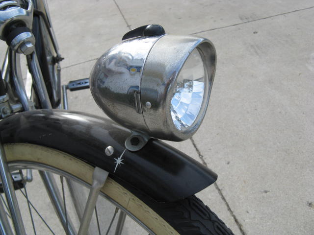

Postby KickBackCycles on Thu Jun 16, 2011 1:34 pm
I got my headlight in the mail today and it looks pretty close to a Delta.
I haven't decided if I am going to paint the whole thing or leave the visor chrome.
I wonder what the two bulbs are for?
