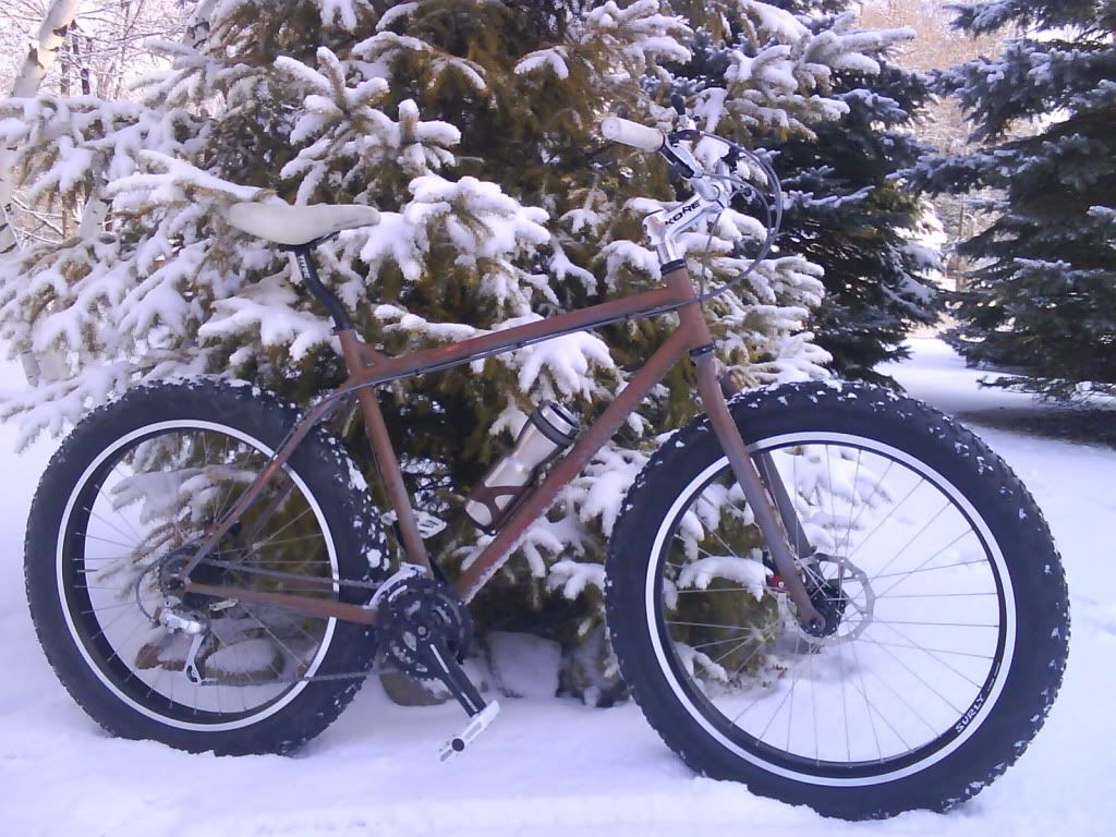

ImageImage[img128152270J][/img]]Hello,
My first time to the site but intrigued by the idea! Just completed a project with a Surly Pugsley frame and fork which I have dubbed "Fat Rat". Will try to post some pics (if I can figure it out). Started hot rodding bikes in the 60's as a kid. Still at it now that I'm heading close to the "60's" again...

those wood fenders are cool

The wood fenders are 1/4" oak plywood. First cut to spec, then wrapped in really hot water-soaked towels for a couple hours. Then bent around a form cut from 2 x 12" to simulate the radius of the fat tire. I left them clamped for about 3 hrs, but it would be better to leave them overnight for the wood to dry thoroughly and maintain the curve. Fenders were then coated with marine varnish and I used bicycle rear rack hardware and some fender stays made from 1/8" steel rod and lock nuts to mount to the Fat Rat.

I like the fenders, they look awesome.

Thanks sweetwillie. They were necessary for the snow/ rain we had in early March. Fairly easy to do as explained above. Would be a cool add-on to any ratrodbike!
