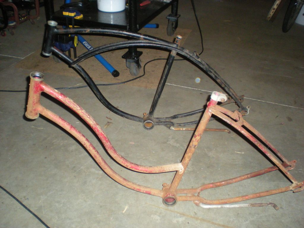

I have this awesome uncle that has a history of building things that are unusual. for example, his 8ft tall "super flyer, or his oversized shopping carts. i told him to keep his eye out for any tandems at a recent car show and swap meet. that is when he offered that I come over to his place and bring a couple bike frames. I though, why not consider it. I am now here asking any of you if there have been any tandem from scratch builds. I have these two schwinn boy/girl frames lying around. both early 50's (corvette/american)

Ive always liked these frames alot. I think i would try to use this styling.

I've tried it. It's doable, I think, but mine was a fail. The main thing I can pass on is that a tandem is longer than the two frames put together. The two people on mine were on top of each other. Most factory tandems add about 6 inches of extra space between them.

I also have some extra road bike schwinns, but I think I would like the looks of a 50's tandem more than a 70's. Just personal preference I guess. Any handmade tandem is impressive though. I am sorry that yours was a fail :( I think that my uncle would be key to making this work well. Only trying would lead to results haha. I hope to do this in the fall, or just after I finish my build off bike. Who knows thanks!
