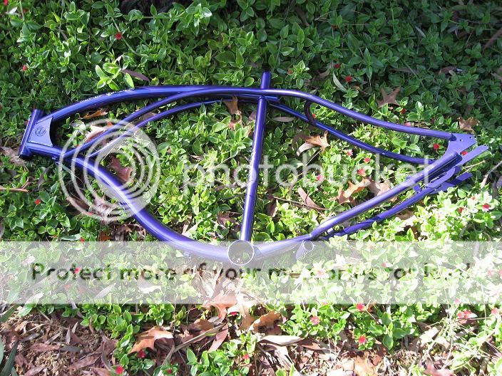

Dual personality, 29er klunker and 24/26 cruiser.

Postby Xcruiser on Mon May 14, 2012 12:43 am
Thats a pretty tight frame man.
But really- Prince??? Purple Rain??? LOL just kiddin!
Its actually a cool name.

Xcruiser wrote:Thats a pretty tight frame man.

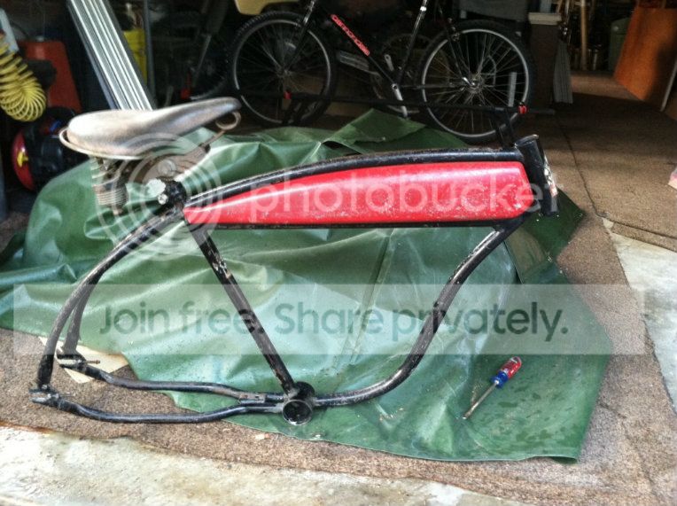

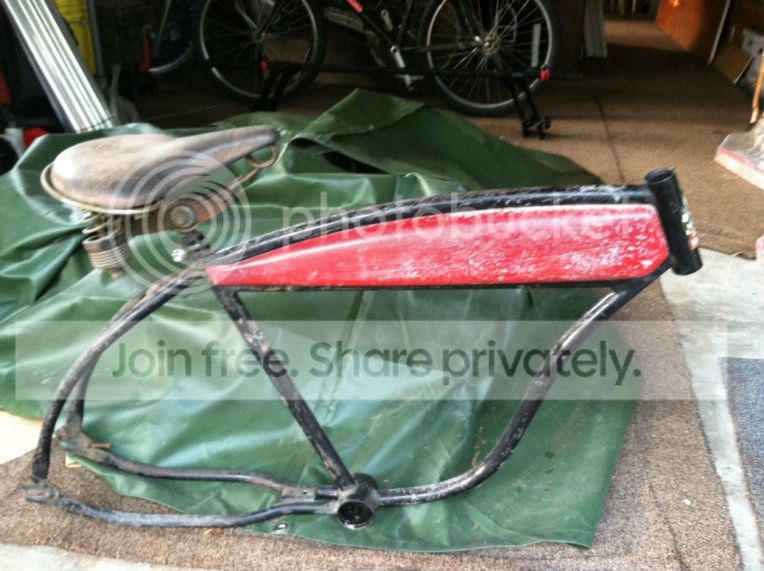

There's a GIant brand mtb called Reign also, so it all came together. Almost was gonna use this CWC I've had laying around for years, but noticed the lineup was lousy with CWCs this year, even cleaned it up a bit.
Post quick cleanup
So it was back to the pile. Have had this Dyno Moto for about 4 years without touching it, but was starting to build another bike and went to use a 24/26 whellset I had forever and boom it's 130mm coaster hub spacing! Look around and the Dyno fits it.
So it'll take the 24x3 with room to spare
As a plus the 26 part of the 24/26 wheelset also has a disc adapter and the Nirve triple tree I've used on several bikes has the tabs for it
The Dyno will also take a 29er rim and tire, but I would need rims(most 29er rims 32H) and fork(suspension corrected 26er or non-corrected 29er) to make that happen plus new axle and spacers for the coaster hub. Could make it a convertible 29er Klunker/Cruiser though I probably have most everything already to do a 26er Klunker at least with a lot less trouble.
