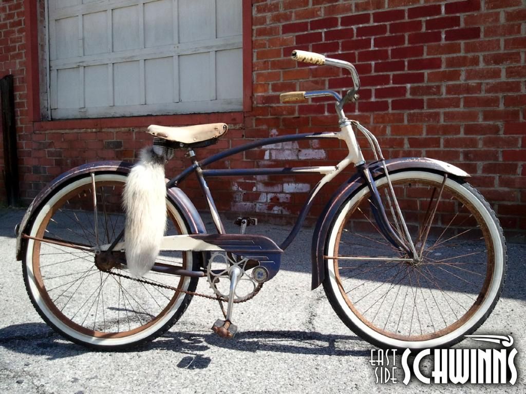

Hello fellas I just posted a few pics in the gallery of my 46 Schwinn, I love the bike problem is it has a Morrow rear and it slips. What I mean by thet is when Im pedaling it feels great but once I stop and coast then try and pedal again, the crank does a full turn before it engages again..and its the same for braking, its about a full turn back before it grabs...anyone else have that problem or know what I need to do to fix it.. also Ive never worked on a Morrow, is it similar to a New Departure D or Bendix Coaster.. or is it completely different..just want to make sure I could put it back together If I decide to tear it down...any help would really be appreciated, thank you! :D
